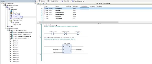

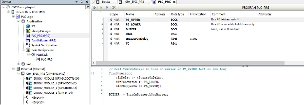

Our simple application consists of two programs. The “main” program, PLC\_PRG calls the subroutine “TurnOnBuzzer”. TurnOnBuzzer takes in both PB statuses, as well as the buzzer delay setpoint, and outputs the desired buzzer on/off state. These two programs illustrate how both text and ladder logic can be used to program your *groov* EPIC in CODESYS.
![DMCPart3_program1](https://blog.opto22.com/hs-fs/hubfs/DMCPart3_program1.png?width=624&height=216&name=DMCPart3_program1.png)
![DMCPart3_program2](https://blog.opto22.com/hs-fs/hubfs/DMCPart3_program2.png?width=624&height=262&name=DMCPart3_program2.png)

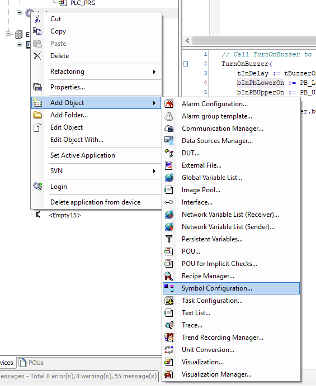

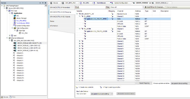

To map your controller's I/O to tags within your programs, configure a mapping on the “State” tag of each I/O point, as shown below. Then, add a “Symbol Configuration” object to your application. This is where you control permissions for OPC UA read & write access of your PLC tags from Ignition or other applications. You can configure tags to be read-only or read/write based on the needs of your application.
![DMCPart3_SymbolConfiguration](https://blog.opto22.com/hs-fs/hubfs/DMCPart3_SymbolConfiguration.png?width=624&height=326&name=DMCPart3_SymbolConfiguration.png)
![DMCPart3_AddObject](https://blog.opto22.com/hs-fs/hubfs/DMCPart3_AddObject.png?width=316&height=386&name=DMCPart3_AddObject.png)
![DMCPart3_afterAddObject](https://blog.opto22.com/hs-fs/hubfs/DMCPart3_afterAddObject.png?width=624&height=308&name=DMCPart3_afterAddObject.png)

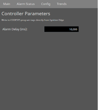

The “Config” tab provides an input field that is linked to our “buzzer on delay” PLC parameter. Here the user can configure the limit for continuous machine runtime before the buzzer is triggered. This provides an example of a tag with read/write permissions between CODESYS and Ignition.
![DMCPart3_ControllerParameters](https://blog.opto22.com/hs-fs/hubfs/DMCPart3_ControllerParameters.png?width=316&height=356&name=DMCPart3_ControllerParameters.png)

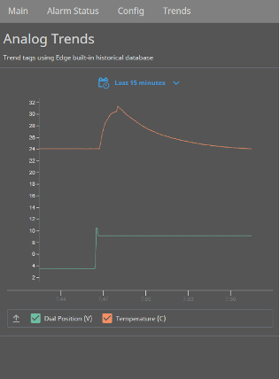

Finally, the “Trends” tab highlights the internal tag historian functionality of Ignition Edge. Without any extra database connections, tags from the *groov* EPIC (both PLC program tags and direct I/O points) can be stored to the Edge historian and trended to monitor values over time.
Here, we have configured the temperature reading from our Thermocouple and the voltage reading from our dial input as historical tags. With Ignition’s sleek and powerful trending tools, these trends can be configured and displayed in minutes.
![DMCPart3_AnalogTrends](https://blog.opto22.com/hs-fs/hubfs/DMCPart3_AnalogTrends.png?width=316&height=428&name=DMCPart3_AnalogTrends.png)
