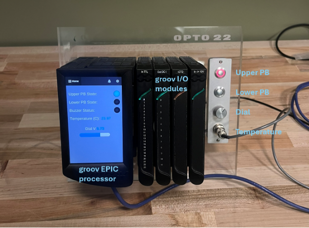

Our Hardware Setup
For this demo, we will be using the following groov EPIC processor and I/O modules.
DMC_EPICLC
GRV-EPIC-PR2 Processor
The GRV-EPIC-PR2 is Opto 22's second generation groov EPIC processor, complete with onboard Ignition Edge 8, Linux operating system, and CODESYS runtime engine. The processor comes with a built-in high resolution touch screen and HDMI port for easy connection to an external monitor.
I/O Modules
  • GRV-IACDCTTL-24 Digital Input module, connected to the two push buttons shown in the above image
  • GRV-ODCI-12 Digital Output module, connected to a buzzer
  • GRV-IICTD-12 Temperature Probe Analog Input module, connected to the thermocouple shown above
  • GRV-IV-24 Voltage Analog Input module, connected to the analog potentiometer dial shown above

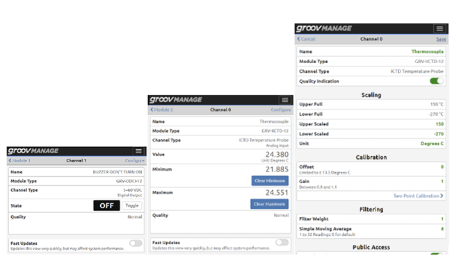

I/O Monitoring & Control from groov Manage
The I/O section of the groov Manage web page contains an intuitive interface to monitor, control, and configure I/O points. This useful tool can make commissioning and I/O checkout a breeze on any size system. Without any external software, users can quickly:
  • Set a name & units for each I/O point
  • Configure scaling, gain, and offset for analog values
  • Monitor the state of inputs
  • Modify output values
  • Configure external access ability for each I/O point
  • And more!
The “batch operations” functionality even allows for some of these operations to be completed in bulk for many channels at once.
DMC_groov ManageScreens

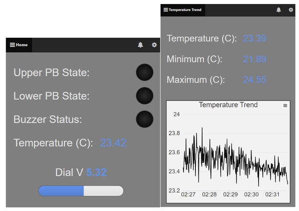

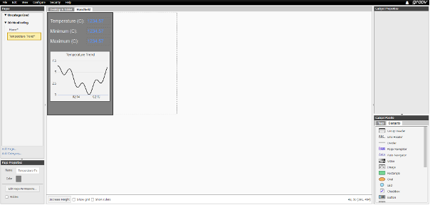

Using groov View as an Onboard UI
Opto 22’s groov View is a no-code tool that can be used to quickly develop custom user interfaces to display on the groov EPIC’s onboard touchscreen. In addition to a network PC. groov View can pull in tags from the groov EPIC’s own I/O or connect to several external data sources including OPC UA servers and Modbus devices. To get started, navigate to groov View from the groov Manage webserver and click the link to open groov View. This will open the home page of your groov View project.
This HMI can be configured by switching to Build mode from the top-right corner Menu button. From Build mode, UI elements called “gadgets” can be dragged onto pages, linked to tags and organized with ease.
DMC_events
Each page developed with groov View has both a Desktop/Tablet and Handheld size, to facilitate use from a PC/tablet or from the groov EPIC’s onboard touch screen. Navigation between pages is also built into groov View, making development a breeze. In minutes, you can have a custom application on the groov EPIC’s onboard screen that combines critical I/O points with external OPC UA or Modbus tags.
DMC_image5
DMC_temp
