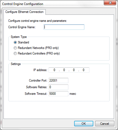

3. In the Select Control Engine dialog box, click Add to open the Control Engine Configuration dialog box, shown below.
control_engine_configuration_db_400x440
4. Enter the name exactly as it was on the first computer (be sure to spell it the same and use the same upper-and lower-case characters, spaces, etc.). Enter the same IP address that you used on the other computer. Then click OK.
